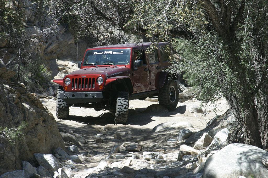

I've got an 07 Jeep Wrangler unlimited. If you look on any board almost all the JK owners are unhappy with their lack of power. My problem is with the 3.8L V6, I don't want to run dual turbos but in order to keep smog legal and all it has 4 cats and multiple O2 sensors. I already got a Superchips which has helped a lot but this is the first thing I've owned in years with less than 5 Liters. Every one else has either done a SC or Hemi conversion. I would like to do a single turbo but it would have to be at least 3-4 feet from the manifold. Any suggestions on a quick spooling turbo I could run "remotely".
Thanks,
Mike
