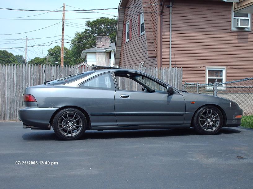

Hi I'm new here and just wanted to say hi to everyone and introduce myself. Im Joe and I have a 94 Integra LS and I work as a Lexus Tech. I'm also a member of Honda-Acura.net and have been there since Jan 04.
Now for the questions. I just got my hands on a Garret T25 turbo off of a 97 Eclipse GST, I also got the SMIC for 20 bucks. This only costed me about 145 for both components. I'm also swapping out my motor(B18B1) for a B20B. Now what kind of manifold would I need to buy to mate with the turbo and head? I've tried a search on here but I couldn't find the info that I needed. TIA, Joe.
This is a pic of my car BTW.
