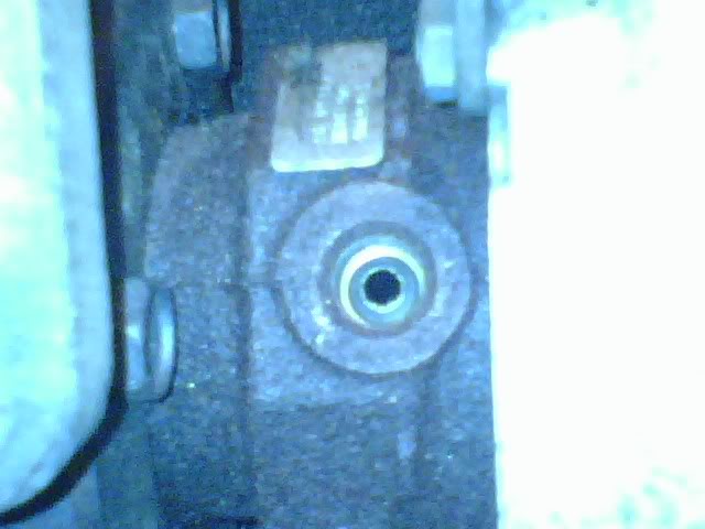

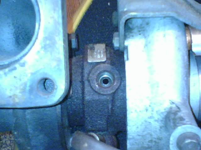

alright ive been searching for an oil feed restrictorr, from like atp, function7 etc. i havent found one besides the adjustble one from stealthmode, and id rather go with a non-adjustable one. everywhere ive checked from the suggestion in the threads only offer em for t3 etc.
i checked if the t3 one would work but, its 1/8th bst/npt w/e it is...i cant rember...well the dsm t25 i have if you dont know uses a 7/16th feed...Now i do have the tuner toys oil line kit for this turbo, and from what ive gathered the opening of the fitting is something alot bigger than the .063 that the resistor should be...
so what have you guys been using as a resistor for this turbo, or is the TT line kit fitting all i need...
thanx -jeff
Ps. hopefully this all makes sense...
here are some pix of my oil feed to tell if i need one or not..

There's no such thing as an oil resistor, and that turbo doesn't need a restrictor.
It's a Stealthmode Oil Line kit sold by Tuner Toys
If you really really want a restrictor, any of the ones made for the GT series ball bearing turbos will fit. They are also 7/16.
