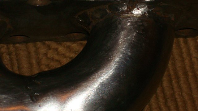

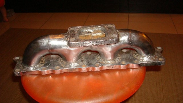

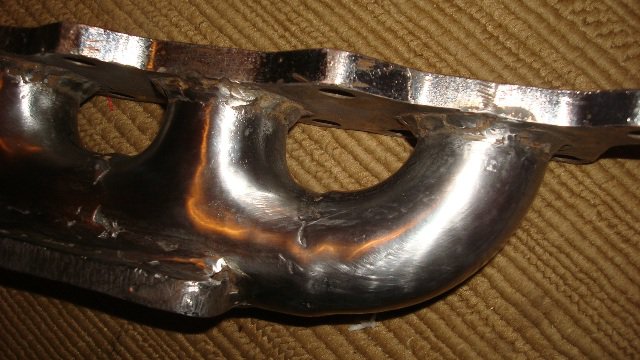

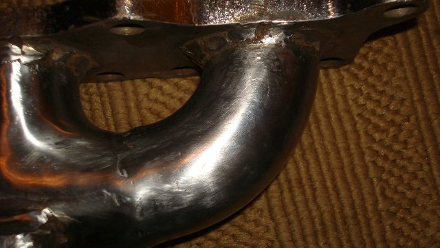

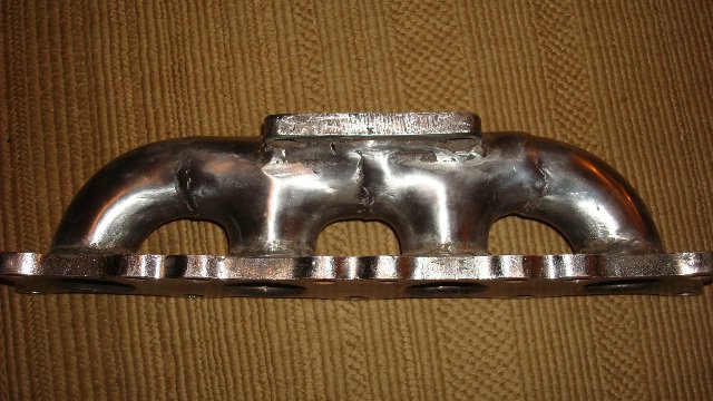

hey guys ,
what do u think of this manifold i made ??

Looks pretty good. Whats it made out of?

i believe they are called weld els

good job. the only problem i see is the header flange is badly warped. you will have to send the header to a machine shop so they can mill it down level otherwise it will not work.

Is it warped or is it just the way the picture is?

actually...kind of both !!!!!!!
i didnt bolt it down while welding

oh well you can get it fixed for less the $30

i have been polishing it and sanding it down ..it looks even better now...how string are these els though...will they last

wtf is an els?
mine is made from schedule 10 stainless butt weld pipe.

if I am not correct, els=elbows.
